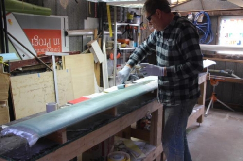

Brief Description:  Canard upper skin layup #2
Second attempt at Canard upper skin layup. A scrape of micro for pinholes and the new exposed foam.
For some reason MUCH easier to keep the fibres straight today. Still used the roller, but stippled extensively afterward, and discovered many air bubbles that weren't visible with the roller. Mmmmmmm. Figuring there may be a perception changed by use of the roller aimed for a fairly wet layup, and didn't really press the squeegee.
1 x UNI, 1 x BID then 2 x UNI, and peel ply all. Covered with heat tent instead of blankets. Checked before bed and maintaining 23C inside, by morning was the same, but 1.7C outside...
Micro, micro
Micro, micro

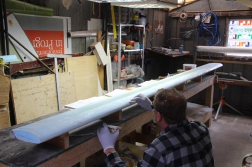

Rolling out final ply
