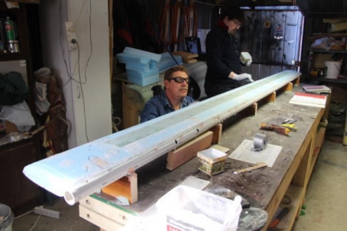

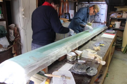

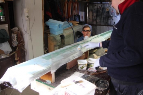

Canard upper skin layup
1 x UNI, then 1 x BID, then two more UNI, overlapped 2" 1.5" 3/4" 0 over leading edge. Peel ply over all.
Used the roller again and it worked really well, achieving a quick wet out and slurping up excess epoxy well. Not so good on peel ply.
Packed up as usual under builders plastic & hot blankies.
Micro, micro
2nd ply
Last ply
