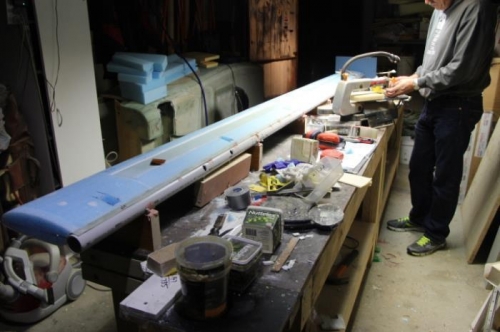

Holes prepared, cutting hardpoint foam

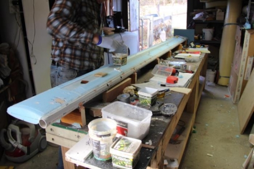

Foam all trimmed
Foam all trimmed

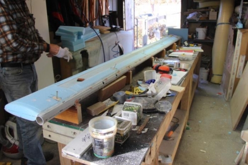

Squooging in micro
Squooging in micro
