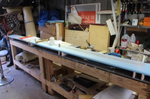

Sanded Tip Attach joggles, taping an inch inboard and using a sanding block, (actually some 3/4" tubular conduit).

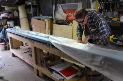

Cut glass for lower skin layups. Rather than using the protractor and straight edge method tried to just cut along the visible thread path, and it worked really well, much more confident that the bits are linear. Cut along a particular thick thread for the UNI, and along the 45 degree pattern so evident with the BID. Used the 0.25" quilter's tape for the first time, and found it far superior for keeping track of the 'guide' UNI thread, and really minimises wastage.

Tip joggles. Hmmmm. This is image 1200 on my camera.
taping UNI for the cut
