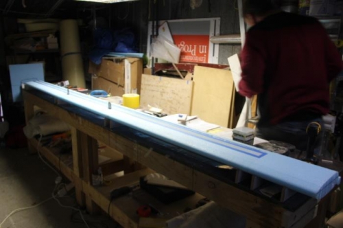

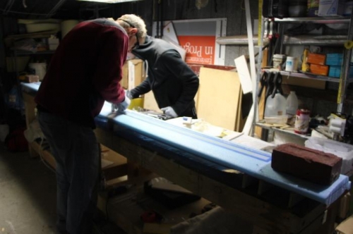

Step 3
Fit Outer Canard Cores
Removed stringline endplates from table, and micro'd on the outer Canard Cores.
Faired edges of Spar Trough with micro.
Filled some dings and dowel holes with excess micro.
fairing in the spar trough
