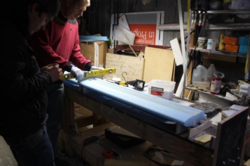

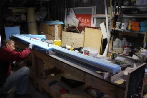

Number of Hours:  1.20
Manual Reference:  Step 3
Brief Description:  Fitting LE Canard cores
Resolved all the jiggery-pokery and micro's LE Canard cores to the TE, LE cores 5-min to jigs.
Inserted dowels into adjusted holes. Found smearing the dowels with micro didn't equate to micro full length. Instead, (after the first two), injected micro into the holes, then inserted the dowels.
Cleaning up drippage
Checking what I have created
