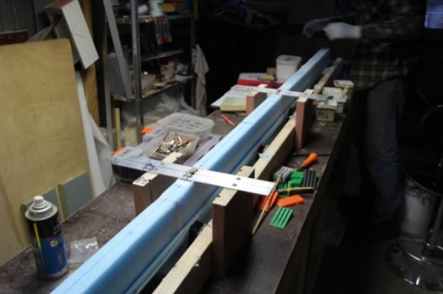

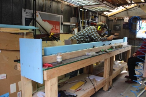

Made cutouts for Tab Nutplates using router.

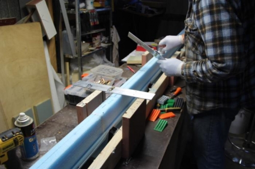

Checked alignment and it has shifted again!!! More string, wedges, then cut down the wedges to keep them away from the Shear Web layup.
Made Tab Nutplate installation jigs and micro'd in the Nutplates, after coating the ends of the bolts with assembly lube.
(Timewarp 19apr15: Should have made the uprights of the jigs further away from the Canard Core jig, to ease strippling and trimming. Should have taped the back of the metal strips so they didn't pick up micro. Could have taped up the face of the plates too.).
