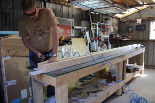

Preparing for Canard Shear Web
Moved tables end to end and levelled.
Fixed 100 x 35 mm pine studs to table, spaced with 3.5" strips of ply.

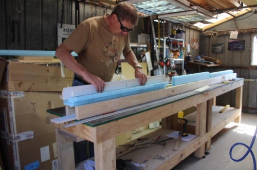

Made a jig for inserting 100mm nails in cores, and so inserted.
Marked centerline of shear web face on cores.
Spent ages farting around with bits of string, levels, wedges & didn't accomplish anything.

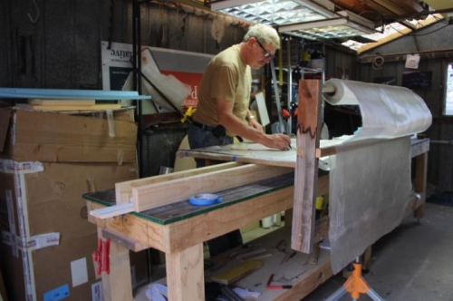

Cut glass for Shear Web and Tab BID pads
Knocking up the jig
Inserting the nails
Mutilating glass
