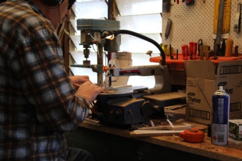

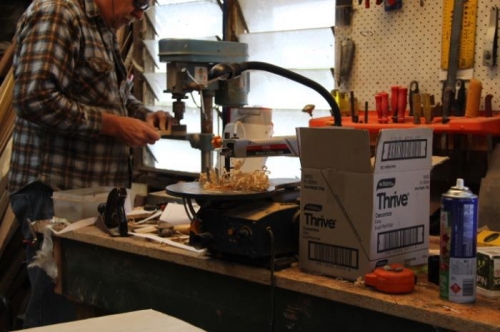

Canard and Elevator Templates
Continued with Canard and Elevator templates from 12mm MDF.
Attached profile with spray glue, cut on electric coping saw, rough sanded on 2" sanding drum mounted in drill press.
Finishing the corners with sanding block and file hard work. Try something else.
Cutting Templates on coping saw
Shaping Templates on sanding drum
