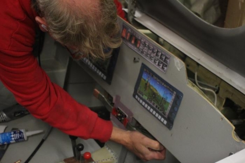

Spent a lot of time pondering the nose gear, and what I need to do to finish it up. Decide step one is to attach the switch, so do so with RTV.

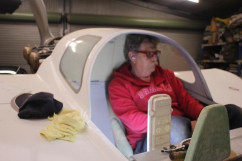

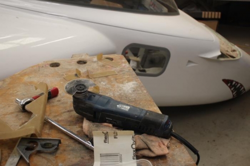

Over the last month all I have done is trim the battery cover, cut up the Featherlite landing brake cover for brackets to mount it and done so. Did not like the result. With it vertical it looks wrong reference the windows, and restricts the head a bit when you sit. Hmmmmm. Pop off the top bracket and moved it aft until the feng shuit calls me... Made a mock PC680 battery to check clearance. Pop the tab back on and 2 x BID tape them all.
Decide the centre armrest needs a bit more overlap in the right rear, so apply it. Pop it off after cure, (took hours of farting around), then clean up the inside and after several iterations, trial fit and trim sessions am happy with it.
