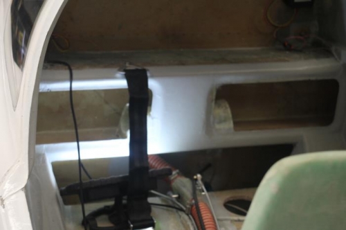

Trimmed and fitted front centre armrests. Front bit will need sheet metal screws.
Trial fitted harnesses to assess required hardware. Plans call out AN4-5A for outer lower, but it looks to me I need 4 x An4-3A. Centre needs threaded rod or An4-27A.
Front upper harness needs An4-10A. Can't actually find anything in the plans for mounting the upper harness in the rear, other than installing the wood hard points. Drill through the centre of these, and open up to 1/4". Needs An4-15A inboard and An4-16A outboard, mounting underneath with An-970-4.
