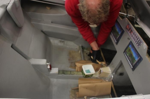

Front centre armrest
Taped up surrounds and hot glued front bit to heat duct/instrument panel. 2 x BID overall, overlapping.
1 x BID inside the other bit.
