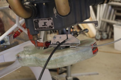

Brief Description:  TBI brackets, linkages and cables
Over the last 3 weeks make a new bracket and lever for the TBI for carby heat, priming and throttle. Mount the throttle cable without any real issues. I will need a spacer at the throttle end, as my careful measurements were not careful enough.

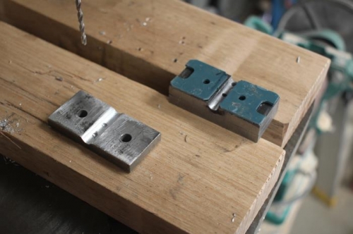

Have made a series of mockups of the carby heat flap and heater flap from non-aviation materials and struggle badly with centering holes.
After many failures make a drilling jig that fits over 1/4" rod and finally get some holes that are centered enough to tap without breaking. Then manage to break off a drill bit in the level hole and do another! My drill press won't hold a bit less then 3mm, so go out and buy a cheap chuck that will go down to 1mm and finally have some lasting success.

Use another drilling jig to make matching brackets and reassemble the lot.
Throttle works!
Throttle works!
Parts-saving drilling jig
