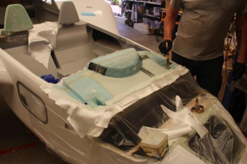

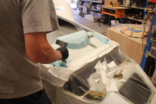

Instrument panel cover - layup
2 x BID over the formwork, cut and overlapped in the hinge cutouts. [Timewarp: Should have layed a drop cloth on the fuselage floor to catch the drips.
