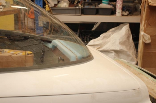

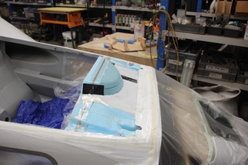

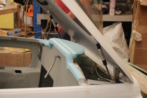

Over the last week started sticking foam to the ip and surrounds to get my head around the cover.
Basically hot glued wing and urethane foam and some coreflute around the panel and worked it until I think it is right.
Removed canopy.
Taped up the form where convenient, and taped and protected surrounding areas.
