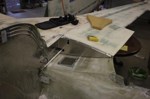

Oil cooler cut-out and bracket
Trimmy, trimmy, all OK.

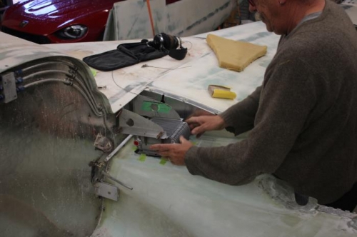

Drilled corners of oil cooler outlet and cut out with multitool.
Mocked up some high temp rubber sealing strips and placed oil cooler with brackets. This makes it sit a bit higher, so adjusted the rudder cable hole and upper profile
