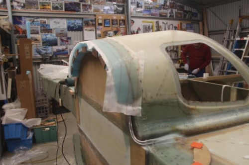

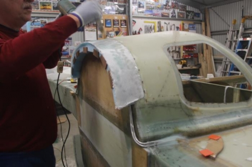

Cowling lip
4 x BID over upper cowling lip and peel ply.
Floxed on 'esthetic' bits of firewall clamped on with hot glued bits of plastic. Had some flox leftover so applied a fillet to the back.
Cowling initial lip
All done
'esthetic' pieces
