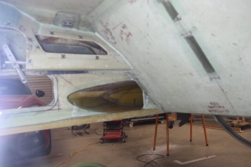

Luggage area taping
Taped port luggage area, 2 x BID, with 1 x 4oz over all seams with fuel behind them, peel ply on the rest.
Fixed tapes to the upper longeron from the instrument panel 2 x BID.
Photography a bit useless, many pictures of the back of my head...
Re-taping instrument panel corner
Tapes done
