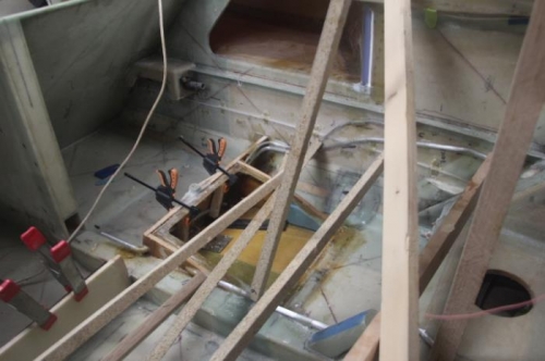

Sump tank lid installation
Trimmed, all OK.
Trimmed sump tank lid a bit more and test installed. Prep sanded bottom of sump tank lid and all mating/taping surfaces.

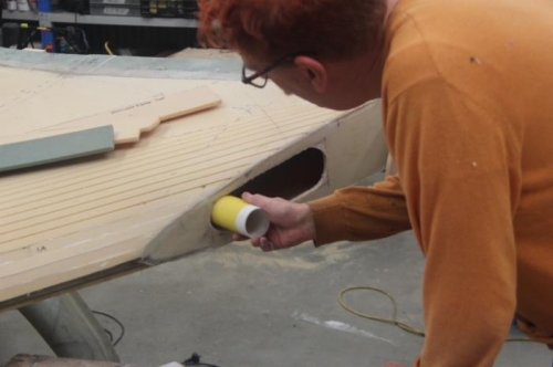

Removed all tube plugs.
Drilled a 1" finger hole in the rear removable armrests, to make them more removable, and trimmed both the clear the new fuel pipes.
Made a test piece to make sure the seatback will fit nicely over the offending fuel pipe, all good.
Trimmy, trimmy
Another view before I remove the sticks.
