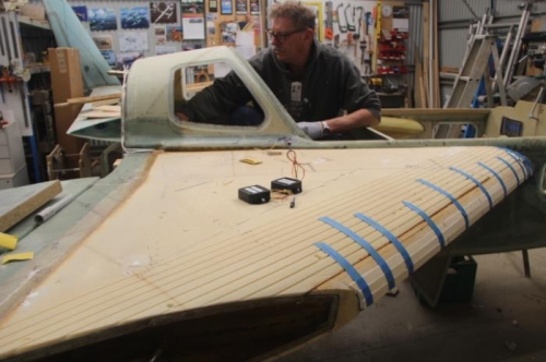

Inside upper engine mount hardpoint
Whilst playing inside the cabin I discover I haven't put the final 1 x BID over these hardpoints. I had prepped the surrounds a while ago, now I faired in the edges with flox and fitted the BID.
