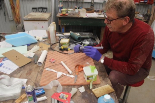

Sight gauges and fuel drains
Trimmed the last tapes placed, all OK.
Drilled through inside skin through fuel drains, cleaned the threads with a tap and profiled the inside where failed tapes are a bit thick.
Trial fitted starboard sight gauge, all OK.
Trimmed the port sight gauge inlet tube floxing and added a bit where the jig got in the way, and floxed the first end.
Trimmy, trimmy
