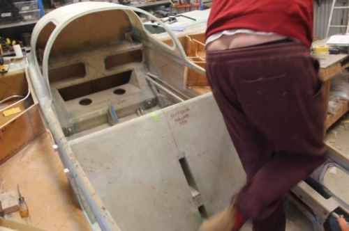

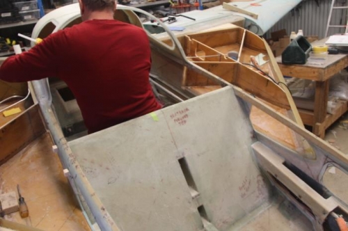

Upper engine mount reinforcement
Floxed in EM-2 engine mount reinforcements inside turtleback, clamped with hot glued wedges. Rough filled the gap between them and the turtleback walls with my bountiful flox.
Clamping the EM-2
Smiling at a job well done...
