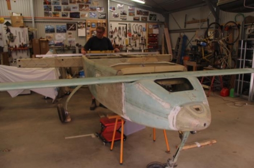

Step one: Fully install the Canard with Elevators for the first time. I have had a bugger of a time getting the Elevator pins in to the point I have never mounted them fully with the connecting spool piece in place. Wayne Blackler reccomended to somebody on the list whilst I was incapacitated use anti-sieze lube on the pins. I gave them a polish and got them both in pretty easily. Go Wayne.

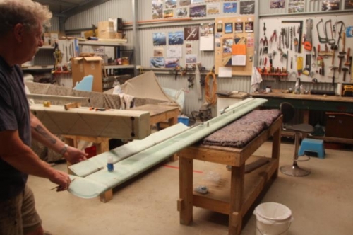

Having firmed my ideas on a fairing attached to the fuselage, marked the elevators for a straight cut about 1" from the fuselage. Mounted the Canard again and contemplated the result.
Continued the measure/mark/trim process as before, including an accurate sight on the Canard
