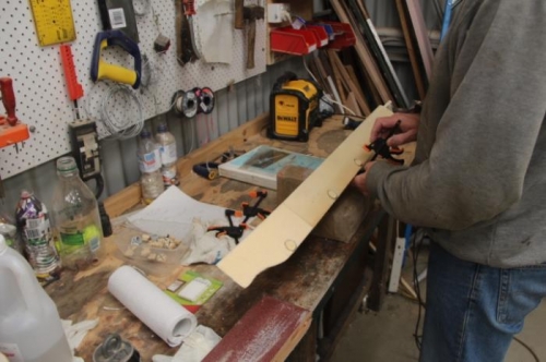

Right removable Armrest skin
Cleaned up and taped off surrounds of rear removable Armrest.
Reamed out the locating holes a bit, to match the left side.
Urethane bonded packing pieces of 18lb foam over locating pin heads, rather than the flox I used last time.
Locating pin packers
