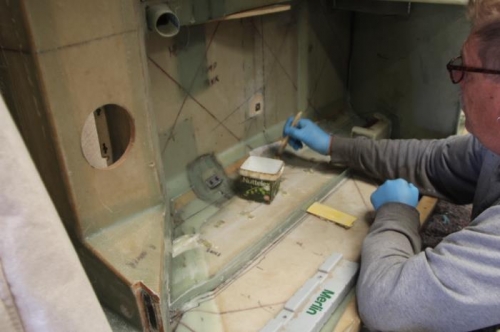

Right Armrests
Applied 2 x BID over fuselage hardpoints, with peel ply
Stipple, stipple
