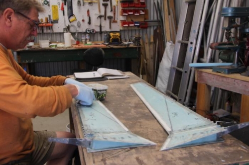

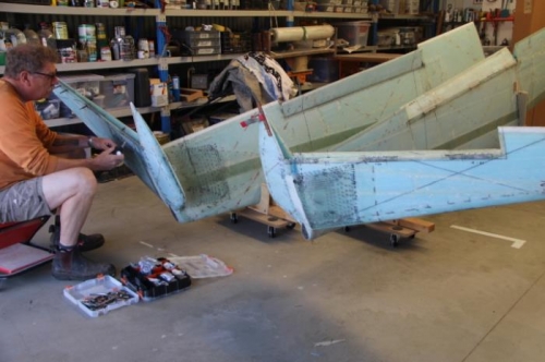

Rudder installation - hinges
Recieved a nice package of stuff from ASS.

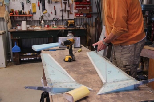

Secured remaining rivet gaps in hinges and hinge pin retainers with BSC-44 pull rivets.
Cleaned grease off with metho, prep sanded and filled head gaps with flox and 1 x BID over rivet heads with 1" overlap
Rivetty, rivetty
Rivetty, rivetty
Tapey, tapey
