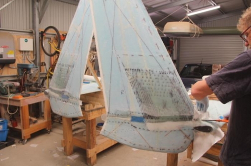

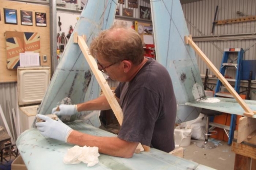

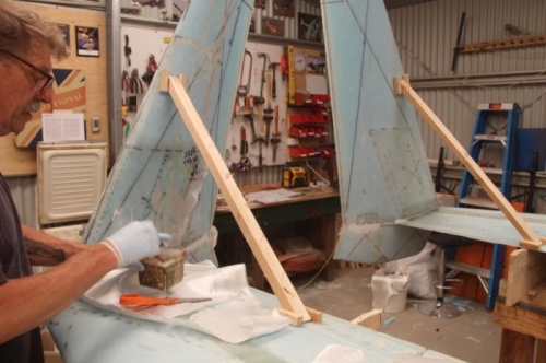

Winglet installation
Micro'd foam and placed tiny flox fillet on Wing/Winglet join.
Did Layup #5, lower Winglet tape 1 x BID, extending over wingtip light mount and surrounding skins by 1", with an extra ply over the mount.
Slapped on Layup #4, the inner structure, 2 x BID and 7 x UND on both wings, alternating between wings for each ply.
Peel ply where possible.
Tapey, tapey
1st ply
Last ply
