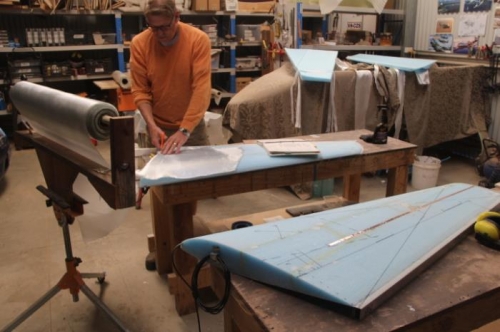

Winglet inner skin prep
Sanded rough fill with 120g and finished foam prep with 240g.
Cut peel ply and BID pieces, UND will come off the roll.
Sandy, sandy
Cutty, cutty
