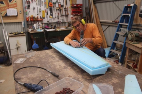

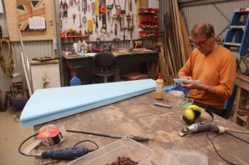

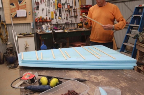

Started trimming glue lines with dremel router, Hot glueing cores to supporting blocks when complete, and bonding these together with some strips of scrap wood about 12 x 5mm. Later, I'll stick these to the bench.
Stuck on the tips with Urethane Bond.
Trimming gluelines
Sticking on supporting strips
