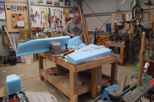

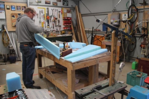

Winglet core assembly
First one came apart OK, so glued up the rest the same way. Method is to squeegee a fair amount of the glue on each surface, the same as I would for micro, then bring them together, and fix with crossed nails so the glue doesn't expand the join.
Spreading some glue
Spreading some more...
