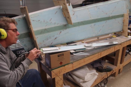

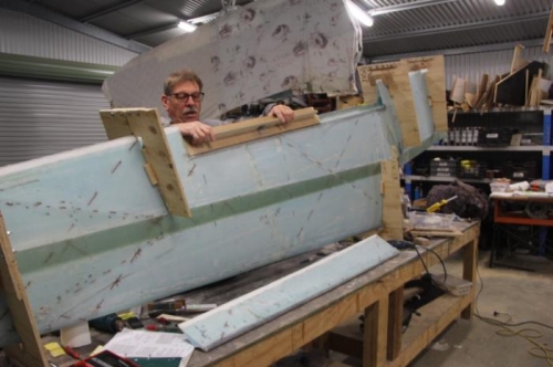

Left Aileron installation
Finished adjusting top gap.
Relieved foam, prepped and 2 x BID over left Aileron end ribs.
Fixed top Wing skin delam #2 using same method as last time
What a thoughtful expression
Tunnelling for end ribs
