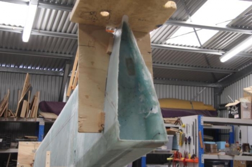

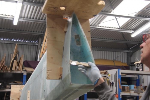

Left Wing BL31 rib repair
Rigged a bit of foam so heat tent wont touch the wing root, this was part of the problem the first time.
Prepped raw foam and 3 x BID over repair area, each layer overlapping 1" on surround. Got a lot of pictures of my back today, bad camera placement.
1 x BID over LWA7 hardpoint
Painting epoxy on the overlap
Wetting out the final ply
