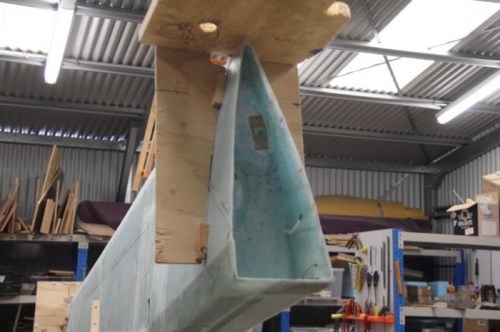

Finished sanding transitions for rib repair. marked up all the plies.
Cut BID for all the areas with the required overlaps, LWA7 cover and CS109/118
Ready for repair layup
