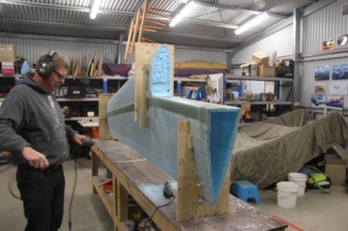

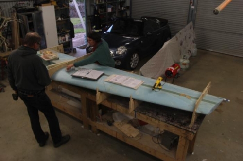

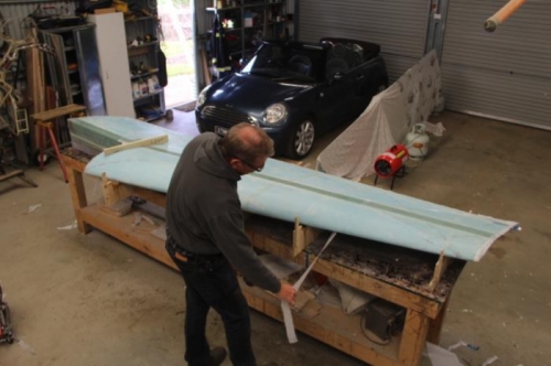

Left Wing inner ribs prep
Trimmed layup, all good.
Refitted the top of jig 4 and bondo'd on the wing levelling board.
Refitted the top of jig 1 and 5 and fixed with hot glue blocks.
Removed jig 2 and 3, the aft half of jig 4 and the TE straight edges to access aileron area and stood wing on trailing edge.
Removed foam 0.7" deep from BL 67.5 root with dremel router and die grinder.
Ahhh! Peel ply!
Fitting the level board
Excavating the wing rib
