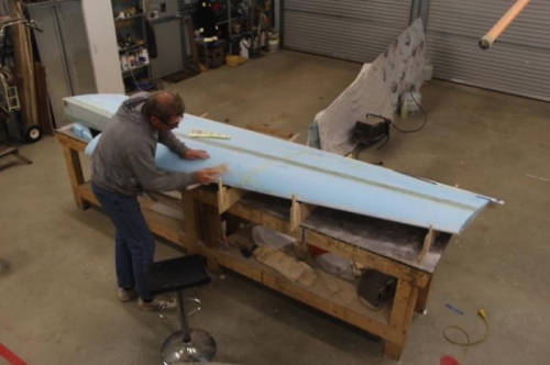

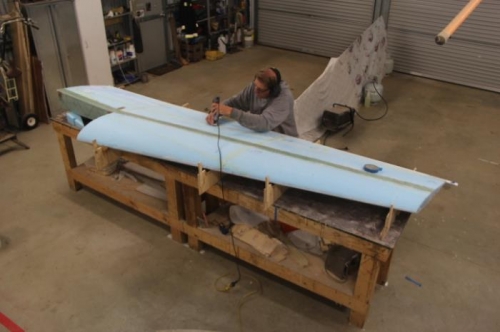

Left Wing top skin preparation
Finished sanding leading edge.
Routed Rudder cable conduit glue lumps and a few other rough joins, and in places a bit of the nyloflow. Minimal filling required, but the micro worked better last time.
220g sanded foam all over and cleaned up.
Routing lumps flat
Finish sanding foam
