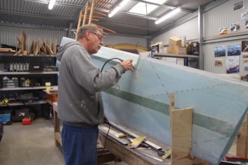

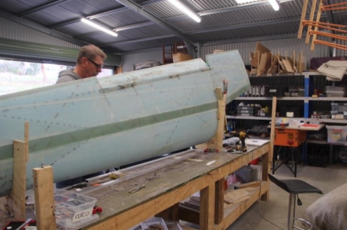

Right Aileron hinges
Removed Aileron, drilled reamed and hardware rivetted mid hinge to Aileron. Just in case, marked all non-aviation rivets with a black marker.
Replace Aileron. It is aligned properly and moves beautifully!
Played for a time with the leading edge Aileron gap on the lower surface, using 1/2" sanding drum and 6mm sanding board. In progress.
Checking hinge action
Opening up the gap
