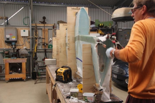

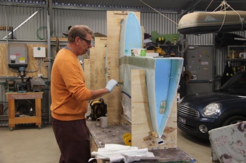

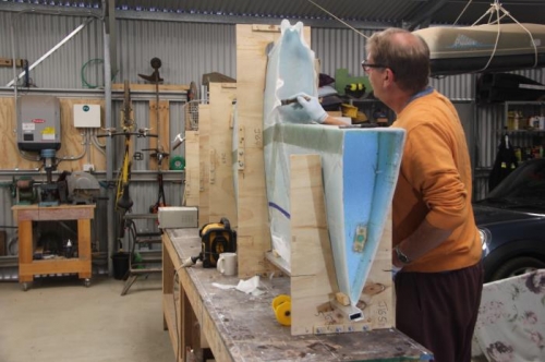

Prepped foam using BBQ syringe to apply bead in corners. [Timewarp: worked brilliantly, but proved impossible to clean, use a baggie next time.]
2 x UND over outboard hardpoint lapped over wings, each bit 30.5" long in total.
3 x BID over outer Wing rib, last one overlapping the fresh UND.
3 x BID over the inner Wing rib. Absolute bastard getting the top bit to lay down, the rudder conduit being another complication.
3 x UND reinforcement over the inboard hardpoint, then clamped on LWA7, omitting the 1 x BID for the moment.
Peel ply outboard reinforcements.
Stipple, stipple
Second ply
Wrasslin' an octypus...
