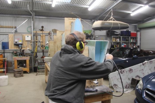

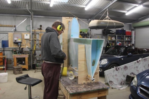

Filled conduit and penetrations of bellcrank tube/flange with modelling clay.
Sanded micro from glass-to-glass areas with Dremel and 1/2" sanding drum. Prep sanded for reinforcements.
Cut UND/BID for reinforcements/ribs.
Prepped LWA7
Filling holes with clay
Sanding reinforcement sites
Sanding, sanding
