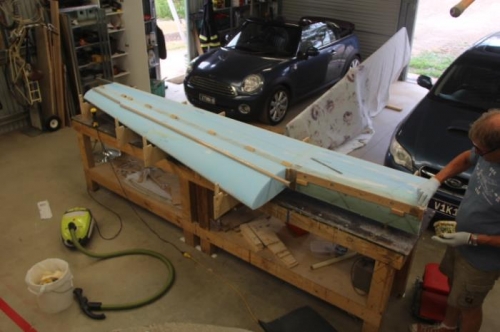

Cleaned up edge of Spar Cap trough, using dremel grinding bit against a straight edge.

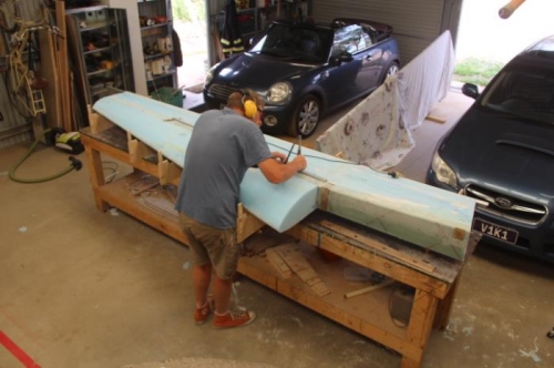

Fitted leading edge dam to RFC-1 with hot glue

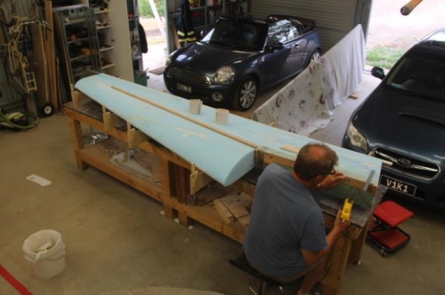

Patched edges of Cap Trough with dry micro. Filled gaps at leading edge against dam with flox.
Cleaning up edge of Spar Cap Trough
Fitting dam to leading edge
Patchy, patchy
