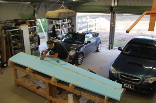

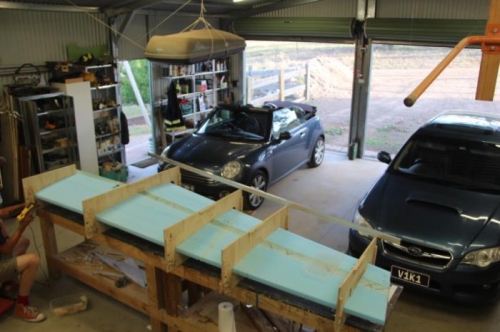

Left Wing, lower Spar Cap prep
Laid Left Wing on tables upper side down. Checked jig alignment with 3.5m straight edge. Secured to table with hot glue and glue blocks.
Removed lower jigs.
Started cleaning glue blobs, much easier than I expected. Very easy to see where the glue stops and the shear web begins.
Glueing jigs to tables
Grinding off glue blobs
