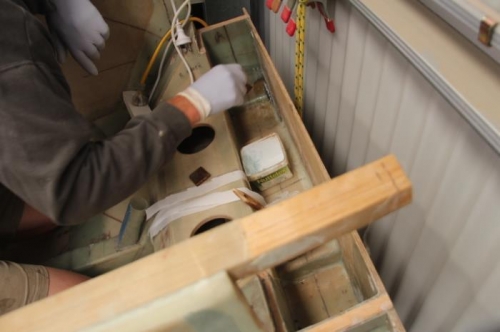

Engine mount hardpoints
Floxed EM-2 to inside of Firewall and 1 x BID overall overlapping an inch or so. Note after cure a bubble on the surrounding foam, can't get at it to fix, so just mashed it flat.
Installing EM-2
