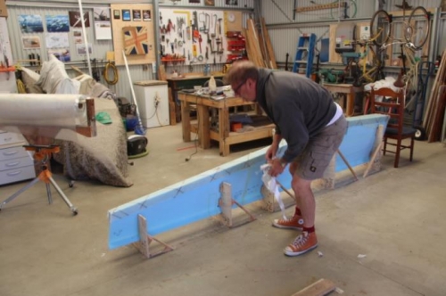

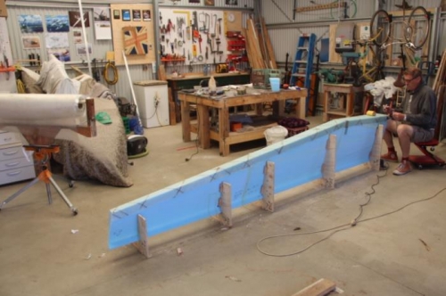

Left Wing Shear Web
Laypup is good, even the LWA6 sites look OK, bit of a lump in the bottom side. Trimmed.

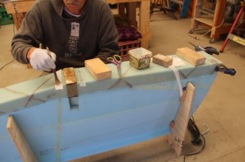

Prepped LWA2/3.
Removed diagonal props from jigs, only dislodging one, refitted with hot glue
Applied 3 x BID pads and installed LWA2/3, weighting with 1/2 and full house brick over taped block. Peel plied edges.
I love removing peel ply
Trimmy, trimmy
Installing more hardpoints
