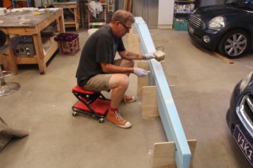

Rounded edges of shear web with 120g sanding block, causing a couple of dramatic gouges in the foam.
Prep sanded foam with 240g sanding block, causing a couple of dramatic gouges in the foam.

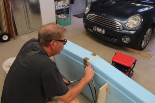

Filled these and previously created dramatic gouges in foam with dry micro and used leftover micro for a bit of hardshelling.

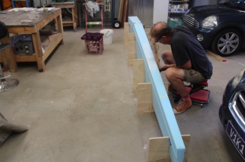

Trimmy, trimmy
Rounding the edge of the Shear Web
Filling dramatic gouges
