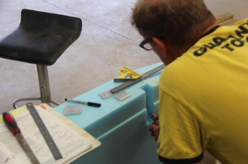

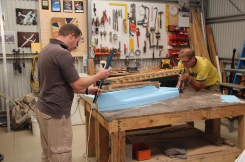

Had a visitor in the shop contemplating building a Cozy, [Timewarp next week: He's ordered the plans! WTG Chris!] Not ready to start the Shear Web layup, and thought it would be amusing to do one, and hot wire something.
Hot wired a winglet, have now read that I am not mad and have confirmed the FAQ says the "right" and "left" are backwards on the template. Sheesh! Next time will jig it upside down, so the foam cores will support the first layup. It is going to be complicated for the first one.

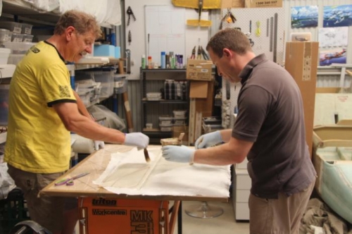

1 x BID over the front seat thigh supports.

Chris and I cutting the Winglet core
Wetting out the front seat thigh supports
