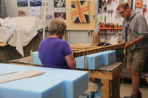

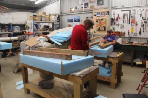

Left Wing Cores
Assembed and marked up foam blocks for Left Wing.
Made end cuts for inboard and outboard blocks.
Made profile cuts for inboard block. Did not use the method of blanking off the Spar Cap and cutting them separately, and it worked fine. Perhaps easier than doing it later. I deem it a dud tip, regardless of how much sense it made to try it.
First end cut LFC 1
Profile cut LFC 1
