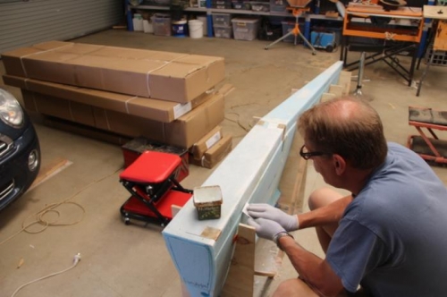

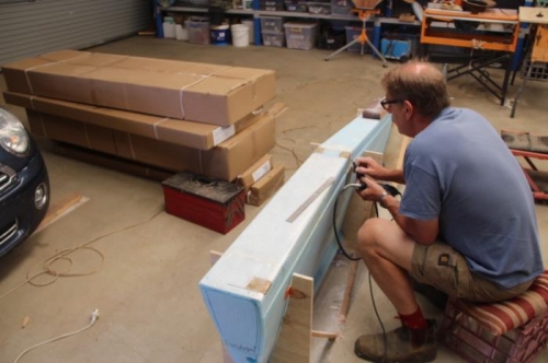

Right Wing Shear Web
Marked up EM-2, leftover from CH14. Started sanding.
Cleaned up W18 flox blobs with Dremel grinding bit, working off a ruler to achieve flatness.
Patched dings in shear web foam with dry micro, particularly in overburnt corners
Grinding some flox
Patching foam dings
