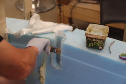

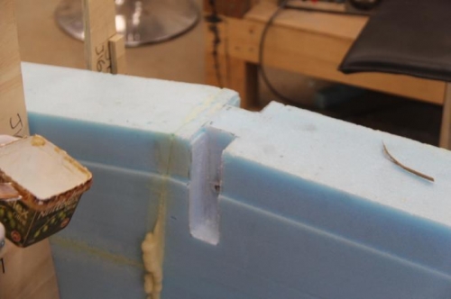

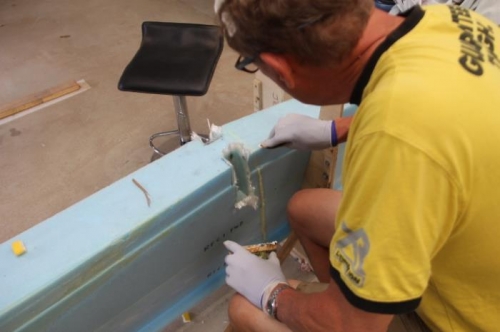

Marked end of drains with black texta. Layed up 2 x BID over inside of Right Wing attach bolt access recess.
Expended leftover resin in dry micro for Shear Web foam dings.
Cleaned metal parts.
Micro pockets
1st ply
Patching dings
