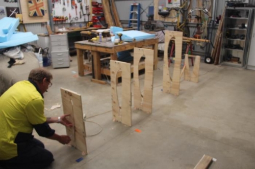

Cut out and trimmed jig repair templates.
There were discrepancies, so adjusted Wing jigs to match the templates with sanding drums and a straight file.

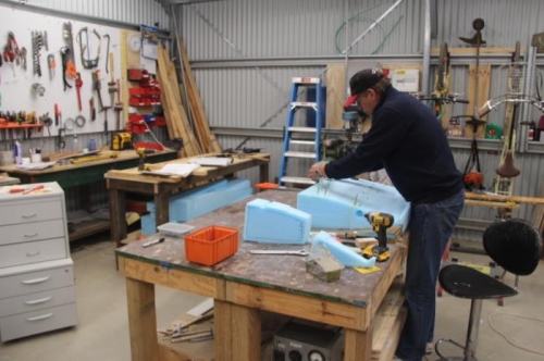

Glued up joints in RFC1/2/3/5 with polyurethane glue, held with large wood screws.
Stabilised the cutlines of conduit and torque tubes with 5min flox blobs, well scraped.
Glueing together RFC1
Trimming jig repair templates
Offering jig repair template to the jig. Doesn't fit!
