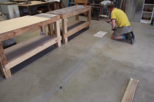

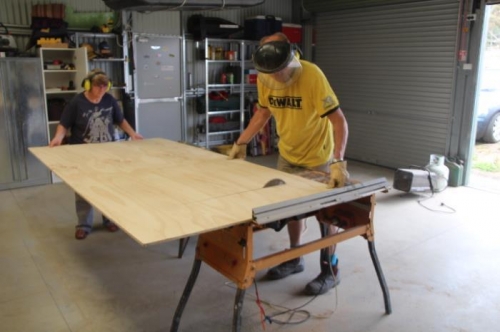

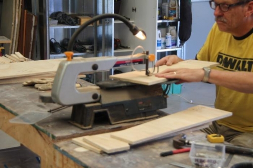

Marked up the floor for the placement of the Wing jigs, then cut them from 12mm structural ply. The Cozy FAQ recommends 5/8" ply, doesn't exist here. Considered marine ply but went with the structural pine after some agonising. Cut outlines on saw table marked them up with templates on clear plastic I made sometime last week and cut the profiles with power coping saw, (slow motion bandsaw). Cut up joining strips, and started drilling and glueing. Didn't see the need for flox, just used PVA wood glue, with some woodscrews added.
The joy of a level floor...
Cutting a whole sheet into 14
Cutting a whole sheet into 14" strips
Cutting the profiles
