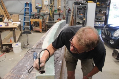

Drilled access holes in ends with 2.25" hole saw. Routed out about 1/4" of foam and filled with dry micro.

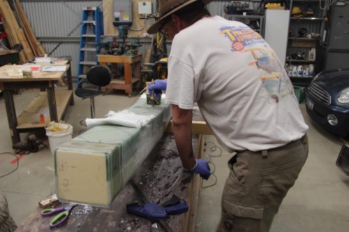

Bonus pic of yesterday's layup
Routing out access hole

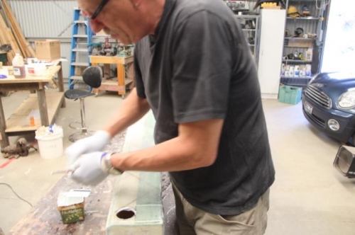

Micro to finish
